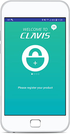

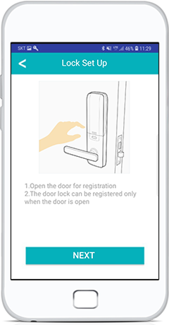

1. Run the CLAVIS application and touch the + button
2. Open the door for registration and tap the NEXT button in the application

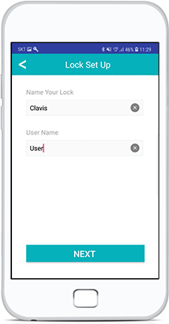

3. Name your door lock and input a user name for your smartphone

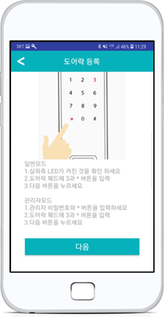

If your Door Lock is in Residential Mode
1. Check that the keypad is lit up
2. On the door lock keypad, press number [3] followed by the star [*] button
3. Tap the NEXT button in the application
If your Door Lock is in Commercial Mode
2. On the door lock keypad, input the master PIN code followed by the star [*] button
3. On the door lock keypad, press number [3] followed by the star [*] button on the keypad
4. Tap the NEXT button in the application

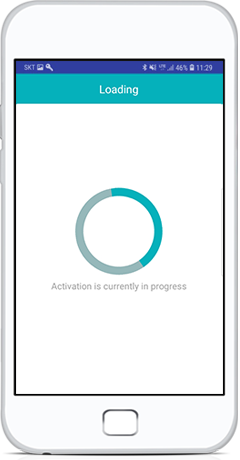

Door Lock Activation in Progress Successful Registration Screen Failed Registration Screen
STEP.03

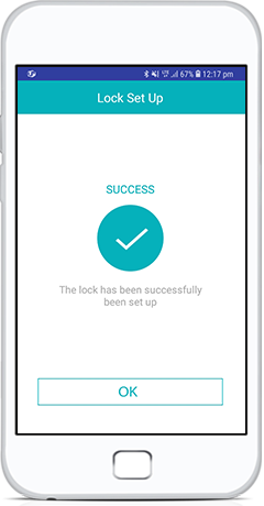

1. The door lock is now pairing with your smart phone
2. Wait for the registration process to complete

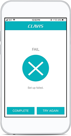

3. If registration is successful, confirm by tapping the COMPLETE button

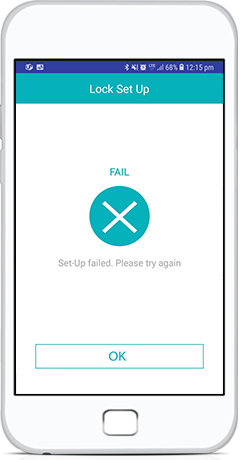

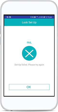

* If registration fails, please refer to the below troubleshooting guide
What to do when Registration Fails
* Please follow the below trouble shooting guide depending on whether your smartphone is using Android or Apple iOS
If you are using Android and the registration failed:
1. Restart your device
2. Redo the registration process
If you are using IPhone and the registration failed:
1. Tap TRY AGAIN

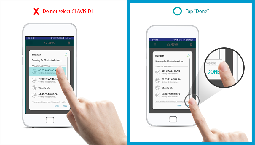

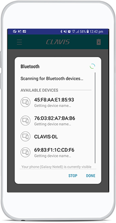

Important Precautions
* Manually pairing the door lock with your smart phone may cause the registration and some lock functions to fail
